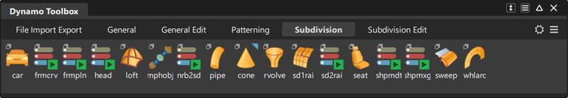

Load a Dynamo Player sample script
  1. The easiest way to load a script into Dynamo Player, is to select it from the Dynamo Toolbox. To open the Dynamo Toolbox, do either of the following:
    • If Dynamo Player is open, click the icon.
    • Select Help > Dynamo Resources > Dynamo Toolbox from the Alias main menu.
  2. Click the icon of the script you want to load.
    If the script you want to run is not available from the Dynamo Toolbox, click the browse icon, and then browse the Dynamo Player folder located in your Alias installation directory. For example:
    C:\Program Files\Autodesk\AliasAutoStudio2024\Dynamo\Sample Files\
    You can set the location for your Dynamo Player scripts using the Dynamo Library Location preference. See the File Paths in the General Preferences.
Tip: If you edit or customize the sample scripts in Dynamo, be sure to save them to a local directory to preserve the originals.
