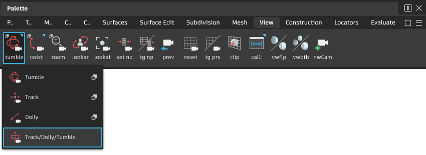

Tracks, dollies, and tumbles with the use of different mouse buttons. We recommend that you use the ViewCube instead of this tool.
Access this tool from the View palette:
