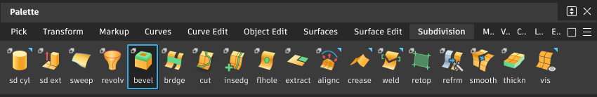

Access the tool from the Subdivision Palette:

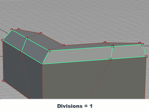

Divisions
Specifies the number of faces to insert between the new edges. A Division value of 1 adds two new edges equally spaced to either side. A value of 2 keeps the original edge between two newly created edges on either side.

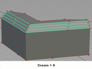

Crown
Creates a rounded crown using the new faces. You need 2 or more Divisions to create a crown. Adjusting this value sets the height of the crown.
A value of 1.0 sets the crown to its the maximum height, which generates a rounded edge. A value of 0 does not create a crown, resulting in a flat beveled edge. By default Crown is set to 1.0.

Note: By default, the bevel edge is rounded when you add two of more faces by setting Divisions to 2 or higher. To flatten the beveled area, set Crown to 0.Adjust the shape of the beveled edge by adding or removing curvature using the Crown slider.
