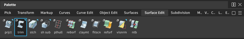

Access this tool from the Surface Edit tool palette:

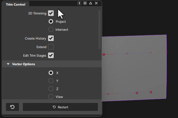

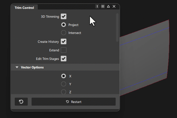

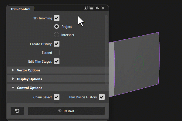

Trim Control settings
3D Trimming
If this box is checked, you can trim the surface along projected curves and cross sections, or you can select a surface and generate a trimming curve automatically from the intersection with the target surface. By default it is unchecked.
Method
Displays when 3D Trimming is selected.
- Project – Creates trimming curves by projecting the selected curves onto the target surface.
- Intersect – Creates a trimming curve from the intersection of the selected surface and the target surface.
You can use the Project or Intersect method in a single trimming operation by toggling back and forth between them.
Create History
If this box is checked, the projected curves have construction history. Editing or transforming the curves and surfaces causes the projection and trim operations to be re-executed.
This option is only available if 3D Trimming is turned on.

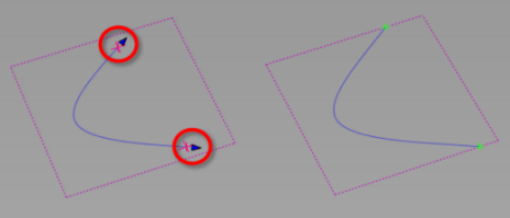

Extend a curve that does not project entirely on the patch, either automatically or manually, and continue the trim operation without leaving the tool.
Auto
When the trim fails, any curves-on-surface that are within the set Tolerance of another curve-on-surface or boundary are extended and the trim is attempted again.
Selected
A trim extend arrow appears on the curve that needs extending. Clicking the arrow snaps the end of the curve to the patch edge.

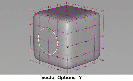

Vector Options
These options are only available if 3D Trimming is turned on.
X, Y, Z
Specifies a projection vector along that axis.
View
Specifies a vector normal to the current view. The vector is not drawn in the view windows.
If the current view is changed, click Refresh View Vector to update the vector.

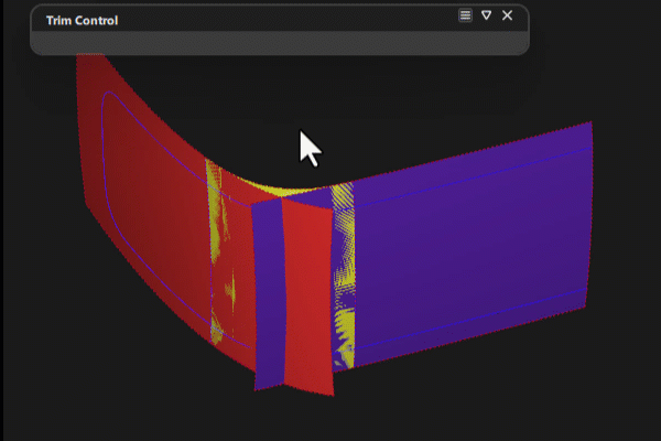

Show Overlap
When on, the tool detects overlapping curves-On-Surface and displays the affected area with a red line. Show Overlaps is on by default.

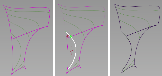

About trim regions
When trimming surfaces, you can specify which areas of the surface to discard, keep, or divide. These areas are known as the trim regions and are indicated by trimming region selector. Each selector displays a different color based on the selected trim operation: Keep, Discord, or Divide. Use the Region Selector Length option to adjust the size of the selector in the canvas.
| Operation | Description | Region Selector |
| Keep | Keeps the selected regions and discards the rest. | ![]() |
| Discard | Discards the selected regions and keeps the rest. | ![]() |
| Divide | Divides the selected regions from the others, making separate trim surfaces, but keeps all the regions. | ![]() |

Shift-select the Trim Surface tool.
In the control window, turn on 3D Trimming and choose either Projection or Intersection.

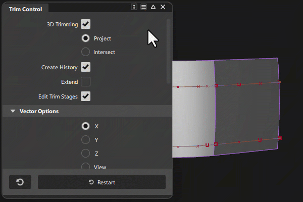

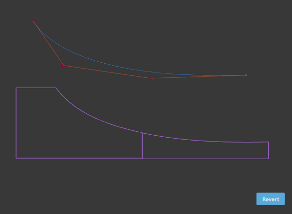

Edit trim stages
The Trim Surface tool automatically saves each stage of the trim operations performed on a surface. You can access these trim stages when the Edit Trim Stages is on. Manipulators display on your trimmed surfaces, which you can use to navigate forward or backward through each trim stage. You can then choose which trim stage to edit while leaving all other trims unaffected. This way, you do not need to use untrim All or Last to make updates. Note that while editing a trim stage, you can move the trim region selector to specify a different trim region.
View trim stages
- In the Trimming Control window, ensure that Edit Trim Stages is on. This options is on by default.
- After trimming, select the trimmed surfaces you want edit.
- Select the arrow manipulator on a surface to go back to the previous trim stage. Hold
Shiftand select to see the trim stages of all the selected surfaces.

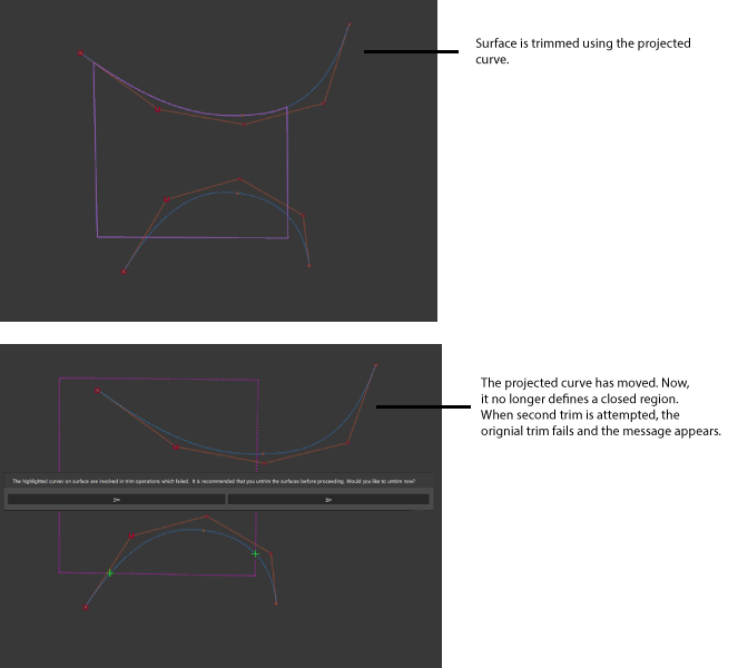

Edit trim stage
For example, you can replace the COS used to trim a surface and retrim with an updated curve.
Select the surfaces trimmed by the COS you want to update.
Select the arrow manipulator to locate the trim stage you want to edit.
To replace a COS, first delete it by holding Ctrl and selecting the curves.
Tip: Turn on Chain Select to select multiple curves simultaneously.Select Delete COS.
Select the new curve you want to project and trim with.
If necessary move the trim region locators to the updated trim the area.
Complete the trim with the new curve by selecting Discard, Keep, or Divide.

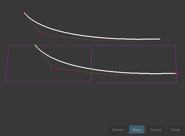

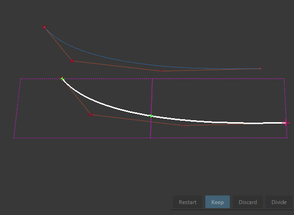

Extend a curve-on-surface (COS)
In some situations, you may need to extend the length of a COS so that it extends to the outer boundary of a surface. Otherwise, the trim operation may fail.
In the Trim Control window, turn on Extend and select either Auto or Selected.
Select the surface to be trimmed, then the COS.
Use the manipulators to extend the curve to the outer boundary of the surface.
Note: By default, the tool uses an extrapolation method to extend the curve. If the tool detects that the curve extension will fail to reach a boundary, the tool automatically switches to a linear calculation to make it successful.Complete the desired trim operation.

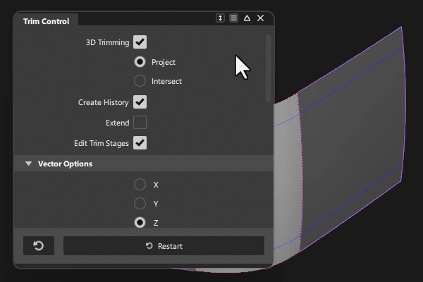

Limit the curve projection
You can limit the distance of a projected curve, useful when projecting curves onto closed NURBS and subdivision objects. For example, setting a projection distance stops the projection from passing through both walls of the closed object.
In the Surface Trim control window, turn on Limit Projection.
An arrow manipulator appears in the viewport attached to two representations of the projected curve at both ends. Drag the manipulator the set the projection distance based on the current position of the curve. You can also enter values for Positive Distance and Negative Distance.

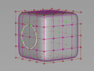

As you select surfaces and curves, the curves are automatically projected onto the surfaces, and the corresponding trim curves are displayed on the surfaces. The direction of the projection is determined by the set Vector Option.The default View, which sets the direction of projection based on the view vector of the window where you selected the curves ( that is, perpendicular to the window). To project normal to the surface, you must select the Normal option.
Note: When Show Overlaps is on, the Trim tool that detects overlapping curves-On-Surface and displays the affected area with a red line. Show Overlaps is on by default.To limit the distance of the projection, turn on Limit Projection. This option is useful when projecting curves onto closed NURBS and subdivision objects. For example, setting a projection distance stops the projection from passing through both walls of the closed object.
When this option is on, an arrow manipulator appears in the viewport attached to two representations of the projected curve at both ends. Drag the manipulator the set the projection distance based on the current position of the curve. You can also enter values for Positive Distance and Negative Distance.

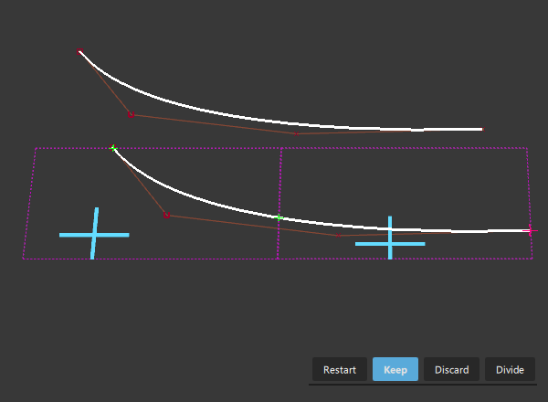

Click on the regions of the surfaces that you either want to keep or discard. (Regions are areas delimited by curves-on-surface). If the trim regions are spread across multiple surfaces, you can box-select them.
Crosshairs appear on the selected regions. To move a crosshair, click it and drag.
If those region selectors appear too large or too small on your geometry, you can adjust their size by using the Region Selector U Size and V Size sliders in the control window.
Tip: You do not have to click a “visible” part of the surface (such as an isoparametric curve). Clicking anywhere inside the surface edges will also work.At any time, before performing the next step, you can change the vector option in the control window to change the direction of projection.
The curves-on-surface update.
Note: If you choose Picked, you must then pick a vector object along which to project.Note: If you choose View, you can project different curves along different view vectors. However, if you then click Refresh View Vector, or select a different vector option, all curves-on-surface update to match the current projection vector.Click one of the buttons: Keep, Discard, or Divide, depending on the type of operation you want to perform.
Keep: Keeps the regions selected in step 5, and discards the rest.
Discard: Discards the regions selected in step 5, and keeps the rest.
Divide: Divides the selected regions from the others (making separate trim surfaces) but keeps all the regions.
In this example, Keep was used.

Note: A successful trim curve is shown with a green marker where the ends of the curve join.
Note: An unsuccessful trim curve — as in this case, where a gap exists — has the two ends of the curve highlighted in yellow to call attention to the gap region.Tip: Use the mouse buttons to control the trim mode by selecting the Mouse Defines Action option under Control Options in the Trim Control window. The left, middle, and right mouse buttons are mapped to Keep, Discard, and Divide, respectively. Click the trim region with the appropriate mouse button and press the spacebar to complete the trim.
Tip: You do not have to click a “visible” part of the surface (such as an isoparametric curve). Clicking anywhere inside the surface edges will also work.Click one of the buttons: Keep, Discard, or Divide, depending on the type of operation you want to perform.
After the trim operation has been performed, you can undo it by clicking the Revert button.
You are left within the tool with all your selections intact, so you can adjust your selections and trim again.
Note: A successful trim curve is shown with a green marker where the ends of the curve join.Note: An unsuccessful trim curve — as in this case, where a gap exists — has the two ends of the curve highlighted in red to call attention to the gap region.Tip: Use the mouse buttons to control the trim mode by selecting the Mouse Defines Action option under Control Options in the Trim Control window. The left, middle, and right mouse buttons are mapped to Keep, Discard, and Divide, respectively. Click the trim region with the appropriate mouse button and press the spacebar to complete the trim.
Split (divide) a surface into trimmed surfaces along curves-on-surface
How to create multiple trimmed surfaces from the trim boundaries of a surface.
Select the Trim Surface tool
.Click the surface you want to split.
Click an area you want to separate. You can click more than one area of the surface to separate. Crosshairs appear on the selected areas.
Tip: You do not have to click a “visible” part of the surface (such as an isoparametric curve). Clicking anywhere inside the surface edges will also work.Click the Divide button in the window.
The tool trims each selected area from the original, and creates a new trimmed surface of the separated area.
After the trim divide operation has been performed, you can undo it by clicking the Reset button.
Trim or divide a surface using cross section
Trim or divide a surface using cross sections
In the control window, check on 3D Trimming.
Note: If you are trimming or dividing subdivision surfaces, ensure that Subdiv Select is turned on.
If you are trimming a surface with its own cross-sections, choose Normal under Vector Options.
Select the surface to trim (hold down the
Shiftkey to add more surfaces to the selection).Select the cross sections to use as trimming curves.
Click on the regions to keep or discard.
Click the Keep, Discard, or Divide button.
Trimming both a regular surface and a trimmed surface with their Y-sections.
Troubleshoot trimmed surfaces
What if...?
I can’t trim a surface because the curves-on-surface are outside tolerance?
To change the tolerances governing trim operations, choose Preferences > Construction Options and open the Curves On Surface/Trim section.
Trim Curve Fit controls the accuracy of the trim boundaries created using the trim tool.
Max Gap Between Curves is the maximum gap allowed between the endpoints of two curves-on-surface (or a curve-on-surface and a surface edge) to consider them closed when defining a trim region.
If you are applying an additional trim operation to a primary surface that has been automatically trimmed when creating a secondary surface, you may see the following alert message:
You may also see this message if you have performed a trim operation on curves created by projecting or intersecting curves or surfaces. The usual cause of the problem is that one of the initial surfaces (or curves) used to create the trim curve or secondary surface has been moved, resulting in a trim curve on one of the initial surfaces that no longer isolates an area that can be trimmed, and this has been diagnosed when you are attempting to create a new trim on the surface.
For example, this diagram shows a fillet created between two flat surfaces. One surface was moved, resulting in an incomplete trim surface. When attempting to create an additional trim on the surface (the circular hole), the problem with the now-incomplete trim curve was discovered.
