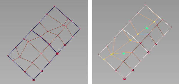

Projects a single row of CVs onto a plane, or all rows of CVs (in either U direction, V direction, or both) onto individual planes.
Planarize hull can be used to provide a good smooth hull shape by arranging the CVs in each row onto separate planes.
For example, use the tool to improve bad hull shapes that sometimes result from procedural modeling through such tools as Square or Rail surface, or direct manipulation of the CVs.

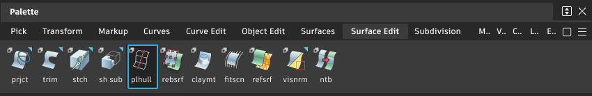

Access this tool from the Surface Edit tool palette:

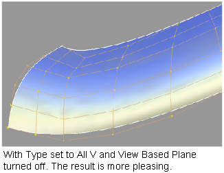

  • All U – Affects all CV rows in U direction (except possibly the first and last).
  • All V – Affects all CV rows in V direction (except possibly the first and last).
  • U and V – Affects all CV rows in both U and V directions (except possibly the first and last). For the last three settings, the first and last rows of CVs are only planarized if Include Edges is turned on.

  • View based – The plane is calculated from the view vector (perpendicular to the active window) and the vector joining the end CVs of the row.
  • Best fit – The plane is chosen as the one that best fits the set of CVs (similar to a least-square fitting) while going through both end CVs.

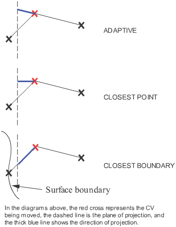

Project Vector
This option determines the direction of projection for each CV.
  • Adaptive – The direction of projection is along the hull line that is closest to the perpendicular of the plane.
  • Closest point – The direction of projection is perpendicular to the plane.
  • Closest boundary – The direction of projection is along the hull line toward the closest surface boundary.
