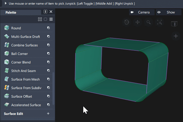

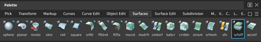

Access this tool from the Surfaces palette:

  1. Shift-select the Surface Offset tool icon.

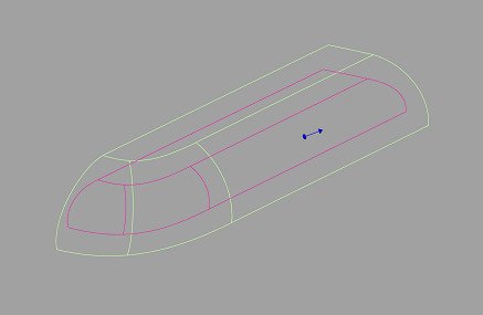

  2. Pick the surface you want to offset. The offset appears in a different color than the picked surface with an arrow indicating the direction of the offset. The image below displays offsets of multiple surfaces.
  3. Do any of the following:
    • Drag the arrow left and right to change the offset distance. You can also change the offset direction by dragging the arrow head or clicking the base of the arrow.
