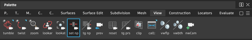

Access this tool from the View palette:

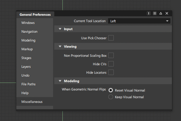

  1. Make sure that Non proportional scaling box is turned off in Miscellaneous section of the General Preferences.

  1. Make sure that Non proportional scaling box is turned on in General Preferences.
