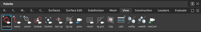

Revolves the view. This tool lets you set certain options more precisely than the View Panel or ViewCube.
Access this tool from the View palette:
Tumble can be used only in a Perspective window. It does not apply to orthographic views.
