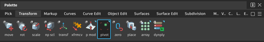

Access this tool from the Transform tool palette:

- Select the Set Pivot tool
. - Click to place the pivot.
