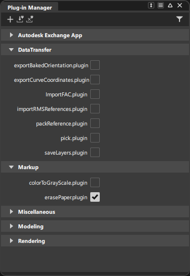

Plug-in Manager
Allows you to load and unload plug-ins that add functionality to Alias. Plug-ins are organized into separate sub-folders in the ODS/OpenAlias/plugins directory in the Alias installation. Any plug-ins located in this directory appear in the Plug-in Manager.
When a plug-in is loaded, you can often access its option in the Tool palette or from the main menu. For example, options for Data Translation plug-ins can be accessed by selecting File > Export.
In addition to the information provided here, documentation for specific plug-ins is provided as text files, located in ODS/OpenAlias/plugins/ under the specific category of plug-ins (DataTransfer, Gifts, Miscellaneous, Modeling, Paint, or Rendering) in the help subfolder. By organizing the plug-ins into separate sub-folders, the plug-ins are similarly organized in the Plug-in Manager.
Important: Only install plug-ins from a known and trusted source. Installing plug-ins from unknown sources can lead to security risks, such as malicious code, that may comprise your computer, design data, and personal information. In the event that malicious code executes on your system, it can be difficult to detect and eliminate.
How to add a new search area
  1. Select Preferences > General Preferences.
  2. In the General Preferences window, open the File Paths section.
  3. In the Plugin search path field, type the folder location of the plug-ins:
    $YOURPATH/plug-ins/lib
  4. Click the Save button at the bottom of the Preferences window.

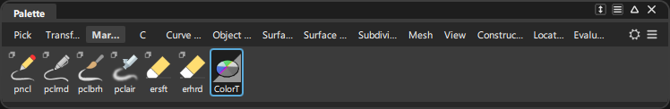

colorToGrayScale.plugin
Use the Color to Grayscale plug-in to change a color image to grayscale. When loaded, you can access this plug-in from the Markup tool palette.
  1. Select the canvas image you want to convert to grayscale.
  2. Click the Color to Grayscale tool in the Markup tool palette.
    The color image is converted to a greyscale image.

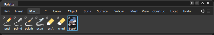

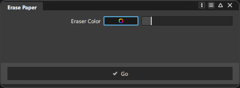

erasePaper.plugin
Use the Erase Paper plug-in to remove a color by making it transparent. After loading this plug-in, you can access it from the Markup tool palette.

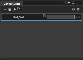

To use the Erase Paper plug-in:
  1. In the Canvas Lister (Windows > Canvas Lister), select the canvas you want to affect.
  2. To open the tool, double-click the Erase Paper tool in the Markup tool palette.
  3. Double-click the Erase Paper color swatch, then select the Pipette icon in the Color Editor.
  4. Use the pipette to select the color you want replace on the canvas.
    You can also use the Erase Color slider to adjust the color value.
  5. Click Go, to replace the color.
    The color is removed.
  6. Repeat the process for another color if needed.
Note: The image layer is duplicated before the color is removed. The new layer contains the original un-erased version, which you can access through the Canvas Layer Editor.

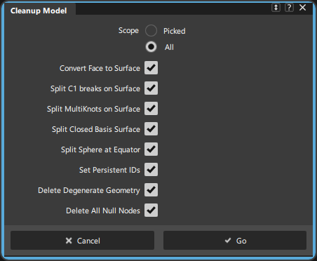

cleanupModel.plugin
Use this tool to clean up the geometry to match the conditions of the CAD systems you are using. After loading this plug-in, you can access the tool from the Object Edit tool palette.
The Cleanup Model tool does the following things:
  • Converts every face geometry to trimmed surface geometry.
  • Checks the connectivity of every surface and every region in a shell.
  • If there are any break, the surface or shell is split at the breaks into more than one surfaces.
  • If the base surface is closed, such as cylinder, the surface or the shell region is split into two non-closed regions.
  • Makes sure every geometry DAG node and every region has a persistent ID. If one does not exist, the tool creates one.
Double-click the Cleanup Model icon, and choose from the following options:

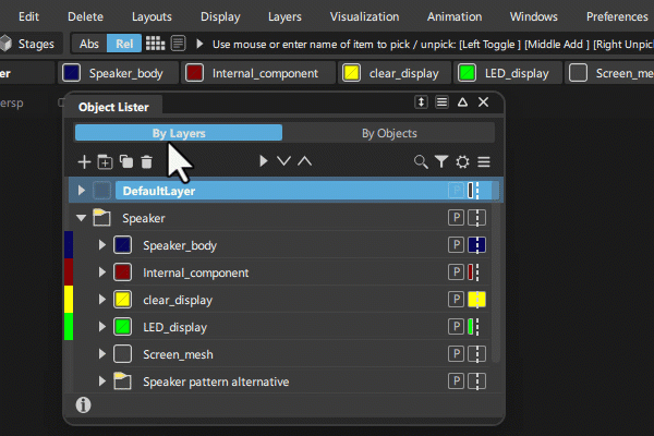

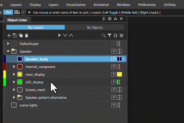

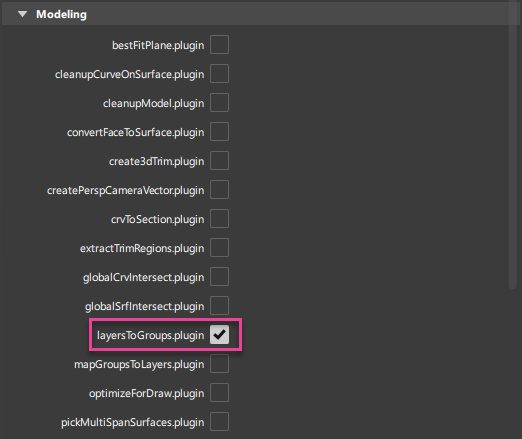

layersToGroups.plugin
Use this plug-ins to quickly create groups from selected layers. This tool takes all the objects contained in a selected layer and adds them to a new group. The new group is added to the source layer and its name is derived from the layer name. After loading the plug-in loaded, access the tool from the Layers menu.
To create groups from a selected layers:
  1. In the Object Lister or Layer Bar, select the layer from which you want to a create group.
  2. In the Layer menu, select +Picked Layers to Groups.
A new group is created containing all the objects from the source layer.

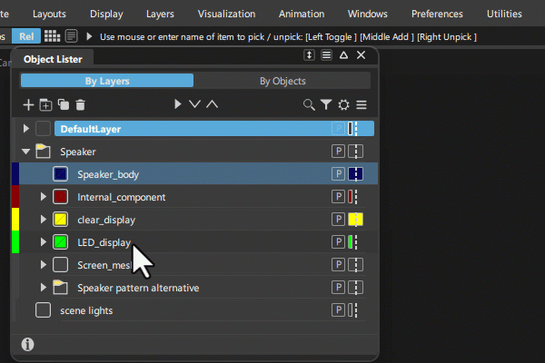

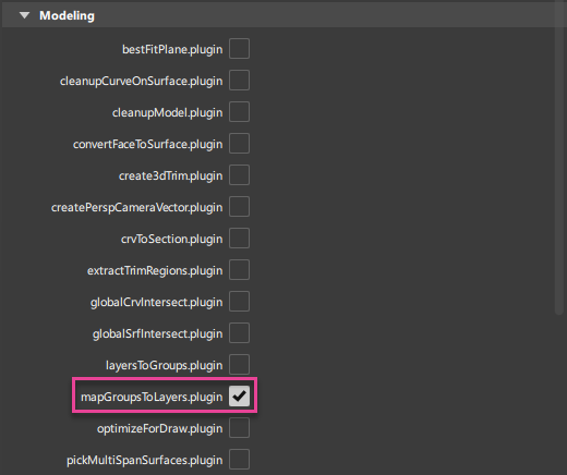

MapGroupsToLayers.plugin
This plug-in provides access to two tools: Group to Layer, which creates layers from selected groups and Group-ChildrenToLayers, which creates layers from each nested group in a selected group. The names of the new layers created by either tool are derived from the names of the source groups.
After loading the plug-in, you can access these tools from the Layers menu.
To create a layer from a selected group:
  1. In the Object Lister, select the group from which you want to create a new layer.
  2. In the Layer menu, select Group to Layer.
A new layer is created from the group.
To create a layer from each nested group in a selected group:
  1. In the Object Lister, select the group that from which you want to create new layers.
  2. In the Layer menu, select Group-ChildrenToLayers.
New layers are created for each nested group.

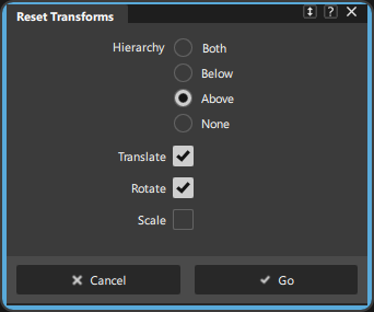

resetTransforms.plugin
Use this tool to reset scaling, translation (movement), and rotation applied to the picked objects. After the plug-in is loaded you can access the Reset Transform tool from the Object Edit tool palette.
