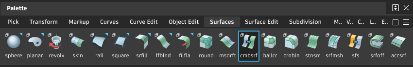

Access the tool from the Surfaces Palette:

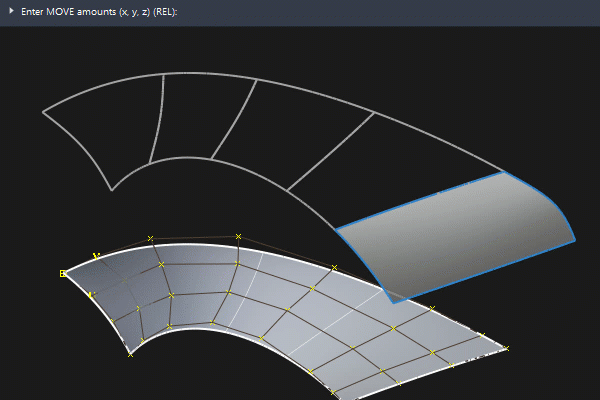

Combine Surfaces workflow
How the tool works
- Combine Surfaces fits four curves to each of the four outer boundaries of the set of surfaces you selected.
- Then, it places a simple surface, of the degree you selected in the option box, within those four curves.
- The tool samples the interior of all the selected surfaces and modifies the surface to match those samples.
- If the surface doesn’t match well enough, Combine Surface inserts isoparametric curves into the simple surface to allow for finer adjustments to the shape.
- If you selected continuity with boundary surfaces, Combine Surface samples those surfaces as well, and increases the samples along the outer boundaries of the original surfaces.
