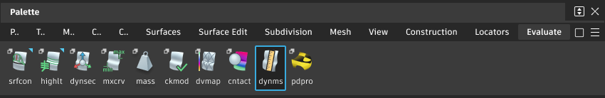

Quickly measures distances. It is especially useful on shaded models during design reviews.
Access this tool from the Evaluate palette:
Dynamic Measurement tool workflows

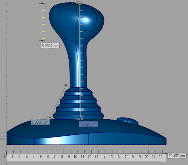

Quickly measure distances on shaded models using the Dynamic Measurement tool. This tool also works on wire-frame models.
Create a dynamic measurement
  1. Click anywhere in an orthographic or perspective window to define the first point. Hold down the mouse button and drag to move the point around.
    A cross-hair appears.
  2. Click somewhere else in the same window to define the second point. Hold down the mouse button and drag to move the point around.
    A ruler appears between the two points and the distance between the points is displayed (in the current linear units).
    Note: Click with the middle or right mouse button, to align the second point horizontally or vertically (respectively) with the first point.
  3. Repeat the steps above to create another measurement in the same window or another orthographic window.
    Note: The measurements are not persistent and disappear as soon as you select another tool.

Anchor a measurement
  1. Move the ruler so the start point is on top of a wireframe, shaded object, or locator.
    The start point turns into a square to indicate that it is attached to the object. The ruler becomes lavender and remains parallel to the view plane.
  2. To free the measurement from the object, just move the start point off it.
A measurement can be anchored in any view, including the Perspective view.
