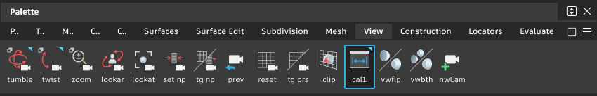

Access this tool from the View palette:

Shift-select the Calibrate 1:1 tool

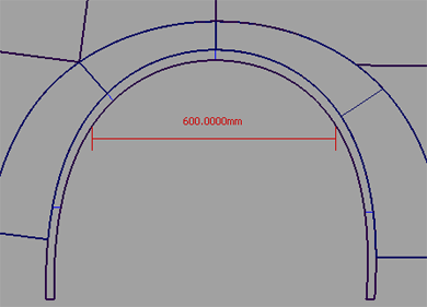

icon.The option box opens, and a distance measurement (red line) appears in the current orthographic window.
Note: This also works in the Perspective window if Perspective is turned off in the Viewing Panel, and one of the preset orthographic views (horizontal or vertical arrows) is clicked in the Viewing Panel.
Dolly in/out if necessary to have the distance measurement fill up most of your window.
Use a real ruler or measuring tape to measure the true length of the distance measurement on the screen.
Enter this value as the Displayed Length in the option box.
Click the Calibrate button in the option box.
