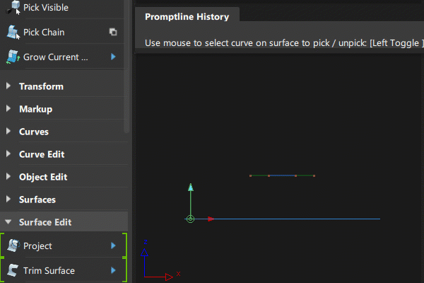

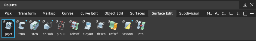

Access this tool from the Surface Edit tool palette:

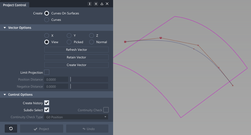

Create curves-on-surface by projecting curves onto surfaces
Shift-select the Project tool.
The control window opens.
Make sure that Create is set to Curves on surfaces.
Select the surface(s) on which you want to project a curve, then click the Go button.
The surfaces turn pink.
Select the curve(s) to project then click the Project button.
The curve is projected along the View vector of the active window, by default. A curve-on-surface is created on the surface(s).

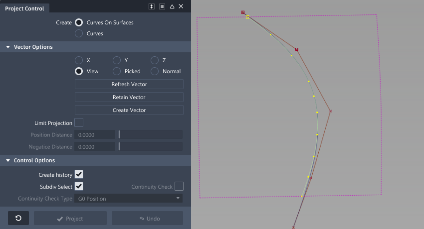

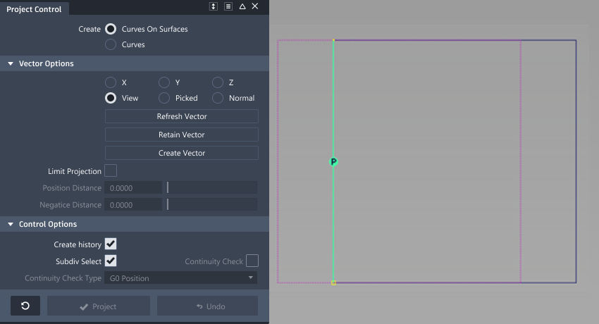

Note: To limit the distance of the projected curve, turn on Limit Projection. This option is useful when projecting curves onto closed NURBS and subdivision objects.Change the view in the Perspective window, then click the Refresh View Vector button. (You can also change the view to that of a different window by clicking in it).
The curve-on-surface updates according to the new view vector in the Perspective window.

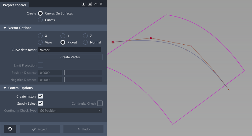

In the control window, choose the Picked vector option, then select a vector object.
The name of the vector appears in the Picked Vector field. The curve-on-surface updates according to the picked projection vector.
