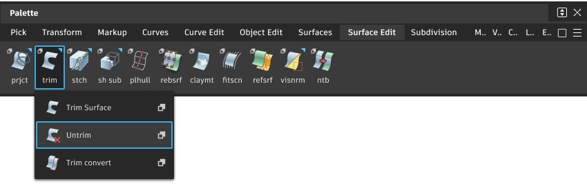

Access this tool from the Surface Edit tool palette:

- In the Surface Edit tool palette, select the Trim > Untrim tool
, then the
icon. - To make the tool undo the last trim of a surface you click, set Untrim Stages to Last.
- To make the tool undo all trims of a surface you click, set Untrim Stages to All.
Reverse trim operations performed on a surface
- Pick the surface.
