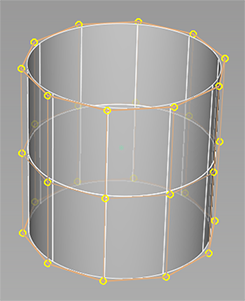

There are four subdivision primitives:
  • Cylinder with 8 radial spans and 1 span in the z axis by default.
  • Box with 1 span in the X, Y, and Z axes by default.
  • Plane with 2 spans in the X and Y axes by default.
  • Torus with 8 spans in the tube section and 8 spans around the tube by default. You can also set the radius of the tube and the distance between the center of the ring and the center of the tube. See Torus primitive settings.

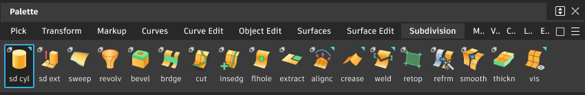

Access these tools from the Subdivision Palette:
Cylinder primitive settings
Spans Radial
The number of radial spans for the subdivision cylinder.
