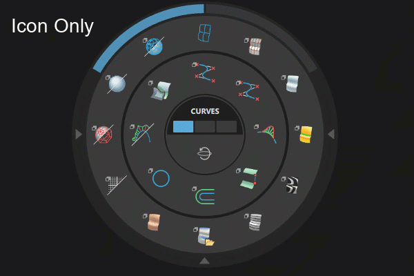

Styling
Choose what to display for the tools in the Custom Puck Inner Ring and Outer Ring : Icon Only, Icon & Text, and Text Only. By default, this preference is set to Icon & Text.
Inner Ring
Use the Maximum Items slider to set the number of items that populate the inner ring menu. After the maximum value is reached, items are added to an overflow area directly below the Custom Puck.
Tabs Control
Lets you choose the behavior of the middle-mouse wheel when scrolling through the center tabs.
  • Wrap Around - Scrolling past the last tab takes you back to the start. This is the default setting.
  • Stop At Start/End - Scrolling stops at the last tab. Turn the mouse wheel in the opposite direction to scroll through the tabs, starting with the previous tab. Scrolling stops at the first tab.
