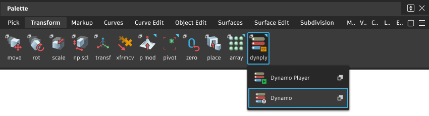

Connects to Autodesk Dynamo, an open source visual programming platform for designers. Use Dynamo to create custom algorithms as script that modify Alias geometry, such as generating surface patterns and other procedural modeling tasks.
Access the Dynamo Player from the Transform tool palette:
