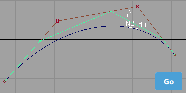

Adds an edit point to a curve, or an isoparametric curve or curve-on-surface to a surface.
The Insert tool shows the new hull shape in green, enabling users to insert CVs with greater visual control over the shape of the curve.Ensure that display of CVs and hulls are turned on to benefit from this feature.

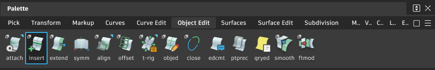

Access this tool from the Object Edit tool palette:
