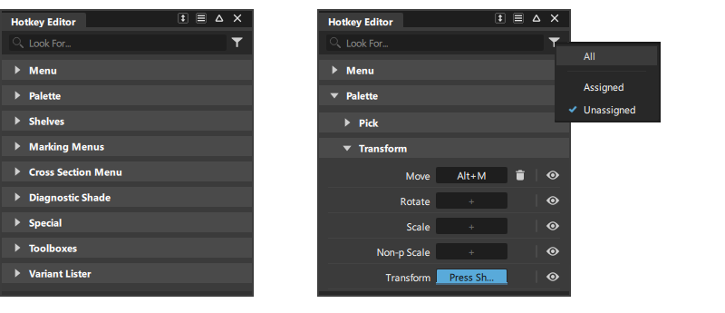

Hotkeys/Menu Editor
The Hotkey Editor lets you add and edit the shortcut keys (hotkeys) for palette tools, menu items, and other functions.

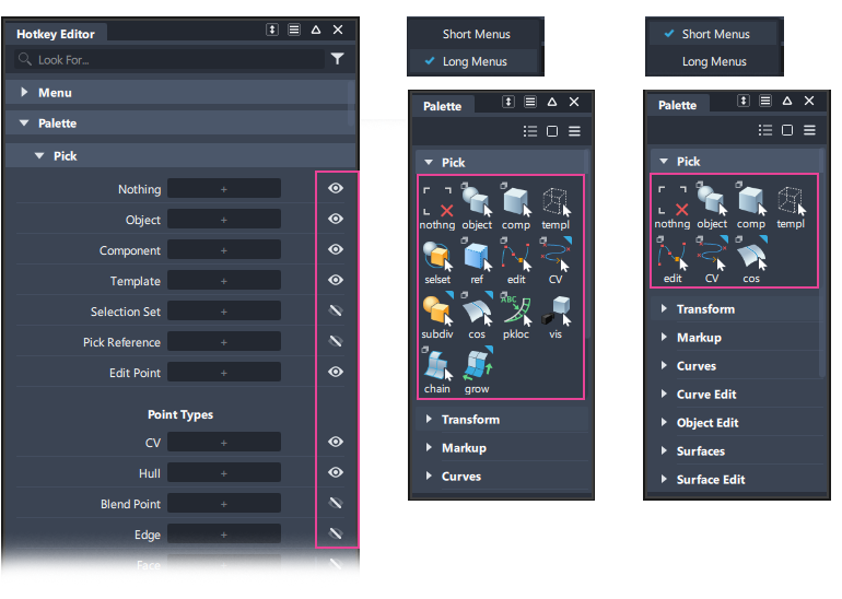

You also use it to select which menu items and palette tools are included in the short menus.
The Menu and Palette tools are listed at the top of the editor, with subsections for each tab or menu in the same order as they appear in the interface.
Hotkeys are assigned by clicking the '+' icon beside a tool name and pressing the required hotkey on the keyboard.

Hotkey Editor icon bar
Search - Lets you use keywords to search for tools and menu items by name. Note: it is not possible to search by hotkey name.
Filters - Displays the tool list according to hotkey assignment.

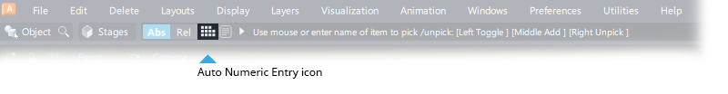

Single character hotkeys and promptline entry
When a key is pressed on the keyboard, the system needs to determine whether the input is a hotkey, or promptline input in response to a tool.
There are two modes that can be toggled using the promptline icon shown below, this replaces the Tgl Single Hotkeys setting in previous Alias versions:
Auto Numeric Input: On.
- Reserved single keys
A
,R
and numbers cannot be used for hotkeys. - When a tool prompts for number input, pressing
A
,R
and number keys will automatically activate promptline entry. You do not need to useTab
or click in the promptline area to activate it for number input. - All other single keys will be interpreted as a hotkey.

To assign or modify a hotkey:
Locate the tool that you want to set the hotkey for.
Click in the '+' field next to the tool name, the field will display in blue with the text 'Press Shortcut'.
Press the required key or key combination on the keyboard.
Press enter or select another hotkey '+' field to enter another hotkey assignment. Either:

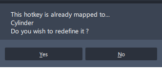

A warning message is shown if the hotkey is already assigned to another item:

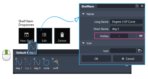

Shelves and Marking menus
This is a dynamic section that will update when new Shelf sets or Marking menu sets are created.
Hotkeys can be assigned for any items on shelves, which means that you can have different hotkeys for the same tool. For example, the Look-At tool is given the default hotkeys Alt + L
and F
both for use in different Workspaces.
The same edit icon is available in the Marking Menu Editor.

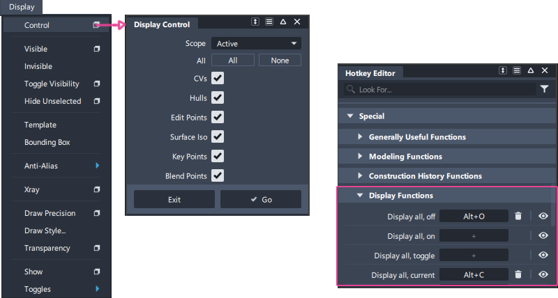

Special
The Special section allows you to set hotkeys for functions that don't relate directly to a single tool, but may be an option within a tool.
For example, Special > Display Functions lists different settings for the Display > Control tool that can be set for quick display of CVs and Hulls:

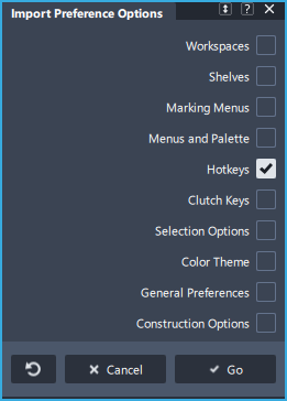

Import / Export a Hotkey set
There is no specific Hotkey import or export tool, instead the hotkeys are saved with the preference Profile. This can be imported to another profile by selecting Hotkeys only to import.
To Export a hotkey set, use Preferences > User Preferences > Export Profile.
To Import a hotkey set, use Preferences > User Preferences > Import and Merge
and turn off all sections other than hotkeys.
