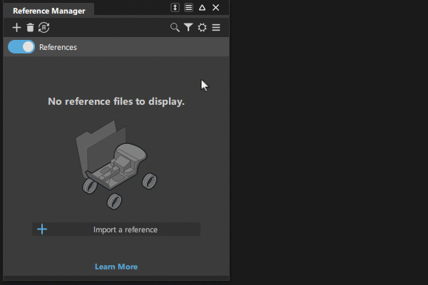

Reference Manager
Imports geometry, such as WIRE files and other supported file formats, to reference data (WREF) files. Using referenced data lets you to work with large data sets while maintaining interactivity in Alias.
You can also use it for alternative shading and comparisons for design reviews as well as a way to support collaborative workflows on design projects. In addition to generating WREF files, the Reference Manager also provides the following features:
- Real time notification of out-of-date and missing referenced or source data.
- Direct access to the locations of source geometry and their associated references (see Reference Manager context menu).
- Ability to designate reference directories so that all referenced data can be centralized in one location (see Set file locations for reference data).
- Ability to create alternative shading comparisons for design reviews (see Reference Alternative workflows).
- Import Alias supported files, such as CATIA V5, directly to references, including reference assemblies (see Reference Assemble workflows).
- Viewing the structure of a referenced file, including layers, layer folders, and groups in the same way its source file displays in the Object Lister.
- Promote references to .wire geometry (see Promote reference data).
Reference Manager icon bar
Import File - Loads geometry from a .wire file, or other supported geometry file types, into Alias as a reference. During the import process, Alias locates any existing reference files (.wref) previously generated from the source geometry file. If a reference file already exists, Alias loads the existing reference file in the viewport (also available in the More menu).
Delete - Deletes the selected references or Alternatives.
Update All - Updates all the out-of-date references listed in the Reference Manager. An icon displays beside a reference in the list to indicate that it is out of date and needs to be updated. (also available in the More menu).
Search - Use keywords to search for layer folders, layers, or objects contained by reference files listed in the editor.
Filter - Lets you display referenced objects by specified type. For example, selecting Surfaces displays only surfaces contained by referenced file.
Setting - Access the Setting menu:
- Hierarchy, Alphabetical - Toggles the display of references by hierarchal or alphabetical.
- Reference, Alternatives - Toggles the display of the Reference and Alternative pane on and off.
More - Access the Reference Manager More menu.
Reference Manager status icons
The Reference Manager provides current status of file references in the scene with the following icons.

Translation Options
Opens the Reference Translation Options window, which lets you set options for translating WIRE and supported non WIRE files to WREF files. These settings are used when you select Import, Re-Import, and Batch Translate from the Reference Manager File menu, as well as when you select File > Import > As Reference from the Alias menu.
WREF Options
- Surface Tolerance: Controls how accurately surfaces are triangulated.
- Curve Tolerance: Chordal tolerance that controls the precision with which curves are drawn after being translated. A higher value will produce smoother reference curves.
- Surface Tesselator: Choose between Fast or Accurate tessellation. Fast tessellation might ignore some local details.
Import options
The translation settings available for non-WIRE file formats are the same as the options in the File Import Options window (File > Import >
). Only settings not used by references, such as Convert Annotations, have been removed.
For information about file import options for non-WIRE file formats, see File > Import File.

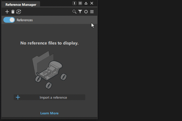

3. Import geometry as reference files
When you import geometry as a reference, Alias converts the geometry to .wref files using the settings in the Reference Translation Options window.

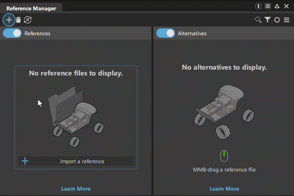

- To import geometry as a reference, do either or the following:
- In the Reference Manager, click the
icon or select Import Files from the More menu. - From the Alias menu, select File > Import > As Reference.
- Browse to the geometry files you want to import.
The selected files are converted to .wref files and saved to the designated output reference directory. The reference geometry appears in the viewport and the Reference Manger now displays your referenced files.

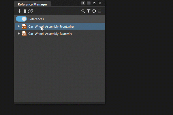

+ dragging them up or down.Modify the appearance of reference data
To make it visible or invisible – Click the small square to the left of the data. You can also right-click the reference file or Alternative and choose Visible from the context menu.
Note: Reference geometry remains visible in the viewport after turning off the model wireframe draw (Display > Show> Model).To make the current reference data visible and all other siblings invisible – Alt-click the small square to the left of the data.
To make all reference data visible or invisible – Shift-click the small square to the left of the data.
To change its color – Right-click on the small square to the left of the file name, and select a color from the lister. To remove the new color overlay and return to the original layer color, select the layer, and then select Edit > Reset Layer Color from the Reference Manager menu.

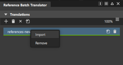

Import converted WREF files
After you convert geometry to .wref files, you can import them into the scene from the Reference Manager.
To import the files from the Reference Batch Translator window, do one of the following:
Click the import icon:
.Right-click a file and select Import.

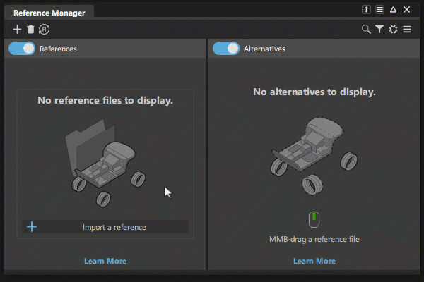

Create Alternatives
If the Alternatives pane is not yet open in the Reference Manager, select Alternatives from the Settings menu.
Select a file in the Reference Manager window, and then MMB drag it into the Alternatives pane.
Alternatives of the reference files are created and appear under an Alternatives group. Alternatives are labeled Alternative, Alternative #1, Alternative #2, and so on. If no reference files were selected, the Alternative will be empty.
The new alternative is selected in the view windows. You can transform it, shade it, and hide/show some of its files of file layers. This allows you, for example, to display different versions of a part located in separate layers of a reference file by creating three alternatives of it and showing/hiding different layers in each.

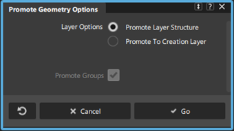

Promote reference curves and NURBS surface to geometry
Select reference data by doing one of the following:
- From the Pick tool palette, select Pick Reference >
, choose the appropriate Pick Level option, and then select a reference object in the scene. - In the Reference Manager select the reference object or the file, layer, or layer folder containing the objects you want to promote.
From the Reference Manager More menu, select Promote > Geometry.
Select from the following Promote Geometry options:
- Promote Layer Structure with Promote Groups turned on (this is the default setting)
- Promote to Creation Layer
Using the information in the table below, select the appropriate Promote Geometry layer option to satisfy the desired promotion result.
Note: Regardless of your selection, a group node is created to hold the results of the promotion for each selected item.

You can promote references containing subdivision object to real subdivision geometry. Promoted subdivision geometry includes the object's faces and the control cage as well as any crease information. All the subdivision objects in your selection get promoted to geometry. For example, if you select a file, all the referenced subdivision objects get promoted, and if you select a layer or group, objects in the layer or group get promoted. Note the following:
- Selecting a single limit surface results in the promotions of the control cage and all other associated limit surfaces.
- Any hybrid modeling operations applied to the referenced subdivision object are not preserved in the promoted geometry.
, choose the appropriate Pick Level option, and then select a subdivision reference object in the scene. - In the Reference Manager, select the reference object or the file, layer, or layer folder containing the objects you want to promote.
From the Reference Manager More menu, select Promote > Subdiv.
The reference objects are copied as real geometry to the creation layer in the Object Lister.

to open the Promote Geometry Options window, and choose how your reference geometry gets promoted. Select from the following options:
