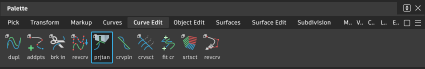

Access this tool from the Curve Edit tool palette:

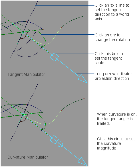

Use the tangent/curvature manipulator to adjust the parameters of the projection, or use the controls in the control window.
Note: Use the Transform Control option in the control window to choose whether to create tangent or curvature continuity.
How do I use the manipulator?
- Click an axis line to set the tangent direction.
- Click an arc, or the square, or circle (if available), then drag the mouse left and right to change the value, or type a number to set the value exactly.
