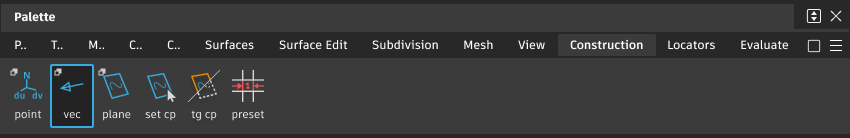

Access this tool from the Construction tool palette:
