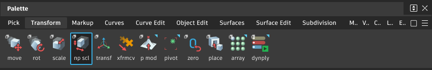

Access this tool from the Transform tool palette:
Scale objects non-proportionally
- Select the tool:
. - Drag the mouse buttons to scale along the different axes, or type scale values for the X, Y, and Z directions in the promptline.
