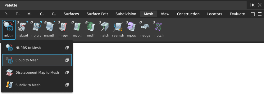

Cloud to Mesh
Converts cloud data to a mesh for processing and editing with Alias mesh tools.
Access this tool from the Mesh tool palette:

Cloud To Mesh workflow
Create meshes from clouds
  1. Import the cloud data into Alias (File > Import > Cloud).
  2. Select the cloud.
  3. Select the Cloud to Mesh tool.
