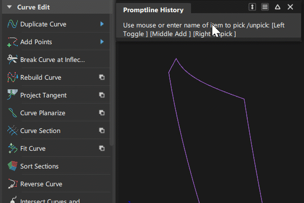

Duplicates any curves that are picked when you click the tool, and any curves you click while the tool is active. You can use box select to pick and duplicate multiple curves at the same time.

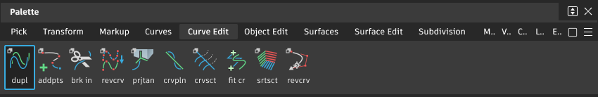

Access this tool from the Curve Edit tool palette:
Create a free curve from existing geometry
How to create free curve copies of free curves, curves-on-surface, trim edges, or isoparametric curves.
