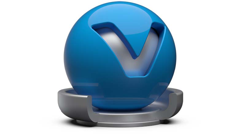

Reflective Plastic
Reflective Plastic
Reflective Plastic is suitable to simulate shiny or glossy surfaces from objects that are made of synthetic materials. It adds the ability to have a mirror image reflection of everything around on its surface.
Reflective Plastic Material
  • Diffuse Color - This attribute defines the base color, the main characteristic of the material. Use the slider to change the brightness. Click the color field on the right to open the color chooser. Assigning a texture to the diffuse color projects it onto the surface. The appearance is a combination of the defined color and the assigned texture.
  • Specular Color - Sets the material’s color for surfaces specular reflections. Use the slider to change the brightness. Click the color field on the right to open the color chooser. Assigning a texture to the specular channel defines areas in which different specular intensities appear with the help of a texture. The specular color depends finally on both the defined color and the assigned texture file.
  • Reflectivity - Sets the specular reflection intensity when the surface normal is directly facing the viewer. The intensity of the reflection increases based on the Fresnel term when the angle between the viewer and the surface normal increases. The higher the value the more the influence from environment and objects around.
  • Fresnel Term Quality - Describes the intensity of a reflection, based on the viewing angle. The material reflectivity or Fresnel IOR parameter control its intensity at normal incidence, depending on the chosen Fresnel Term Quality mode.
    • Fast - Uses a fast, but less accurate, approximation to the Fresnel Term.
    • Accurate - Uses a physically accurate evaluation of the Fresnel Term.
