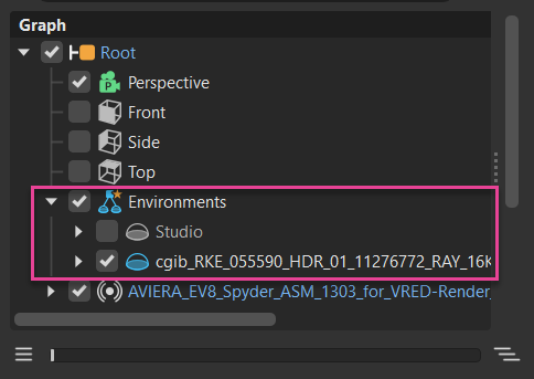

NEW Environments from Alias
As of version 2026.2, a VRED user can live reference environments from Alias, enabling VRED to use the same environment. When VRED pulls in one or more environments from a Live Reference, synchronizing with Alias, an environment switch is created in VRED, containing these environments.
Work with your VRED environment, switch to the Live Reference environment in Alias, or select another from the Live Reference environment switch. Whenever a live referenced environment is modified in Alias, the VRED user will receive an update.
Limitations: The Alias version of the VRED Skylight environment is not supported for Live References.
In Alias, enable the Environment filter in the Live Reference options. The environment, including .hdr images, are display in VRED without need of modification. If the Live Reference contains multiple environments, the active environment in Alias displays by default. As mentioned above, you can switch to a different environment in VRED by selecting another from the Live Reference environment switch.
