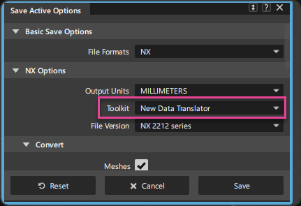

The New Data Translator that we introduced as an alternative to our Legacy translator in Alias 2026 is now set as the default option for CATIA 5, CATIA 4, NX, and SolidWorks data translation.

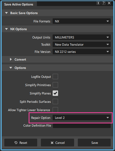

Updates to NX Export
We've added Repair Options, which let you choose whether or not to repair Alias geometry before exporting to NX. In previous versions of Alias, geometry was always repaired before export. Now, you can choose from Repair Level 1, Level 2, or Level 3, which represents increasing degrees of geometric correction applied during export. Setting it to None turns off all repair operations during export. Use this option to preserves CV integrity when exporting and re-importing geometry to the NX .prt format, ensuring accurate geometry round-tripping. This option is set to Level 2 by default, which applies a repair tolerance of 1e-7 meters and offers a balanced trade-off between quality and performance, making it the most practical choice for most scenarios.

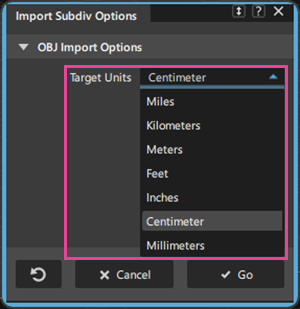

Updated OBJ Import and Export Options
When importing (File > Import > Subdiv) or exporting (File > Export > Active as Subdiv) subdivision objects, a new Target Units option now lets you can now specify the working units for the resulting imported or exported geometry. Using this option can help you reduce making manual scaling adjustments to the output geometry when transferring subdivision data between Alias and other applications.
UI image
