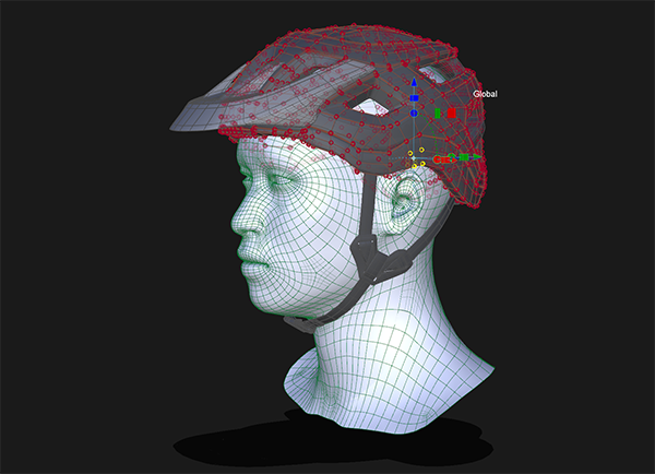

Modular Headshape 2024.1.1-modhd.dyn
This script creates a head model from .tss t-spline subdivision geometry. The script controls allow you to make variations of head and facial features by adjusting characteristics, such as gender, age, and more. Use the head model as a reference object in Alias.

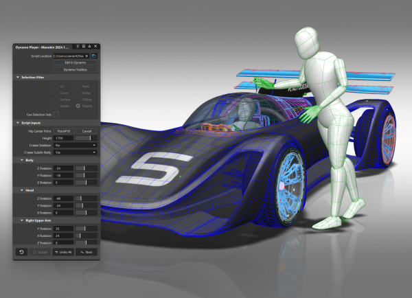

Manekin 2024.1.1.76-mankn.dyn
Creates a full body manikin from subdivision geometry, with rotating joints on the neck, torso and limbs. Position the geometry using a construction point or at the viewport origin (X=0, Y=0, X=0). Use the script controls to specify the height and orientation of the manikin as well as to rotate the limb joints to pose it.

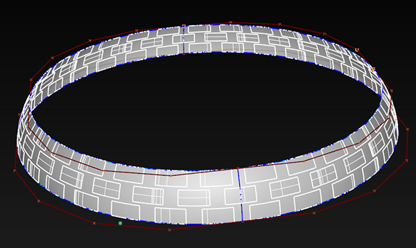

Nurbs Surfaces on Revolved Surface(s) 2024.1.13.dyn
This script creates multiple NURBS surfaces on revolved surfaces. These surfaces are arranged in rings and can be optionally staggered. Set the surface width and height using the script controls or by selecting a reference surface. Use this script to create target reference surfaces for the Feature Modifier tool.

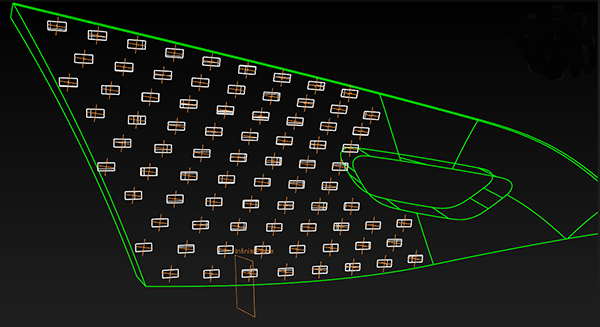

Nurbs Surfaces on Surface(s) 2024.1.10-sfonsf.dyn
Creates surfaces on a target surface using specified construction points for position and a construction plane for orientation. Use the results of this script as a target reference for the Feature Modifier tool.

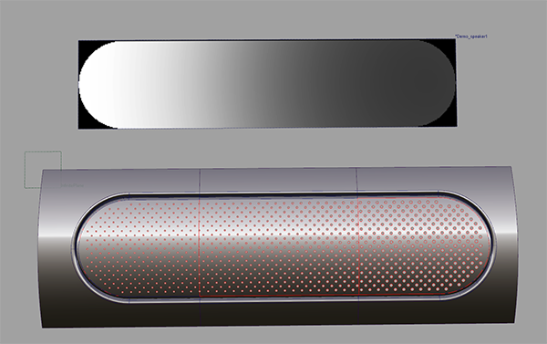

Create Picture 2024.1.11-crpic.dyn
This script creates a black-and-white picture from specified input surfaces. The selected surfaces display in white while the environment displays in black. An active construction plane determines the direction the picture is taken from. Modify the picture result, and then use the picture with the Place and Scale by Picture script.
Place and Scale by Picture 2024.1.13-pasbyp.dyn
Use this script to place and scale the image you created using the Create Picture script. This script uses the image to control the scaling of either circles or selected curves. For example, the brighter the image, the higher the scaling of the curves, and the darker the image, the smaller the curves become. These curves are then used to trim holes into the reference surfaces.
