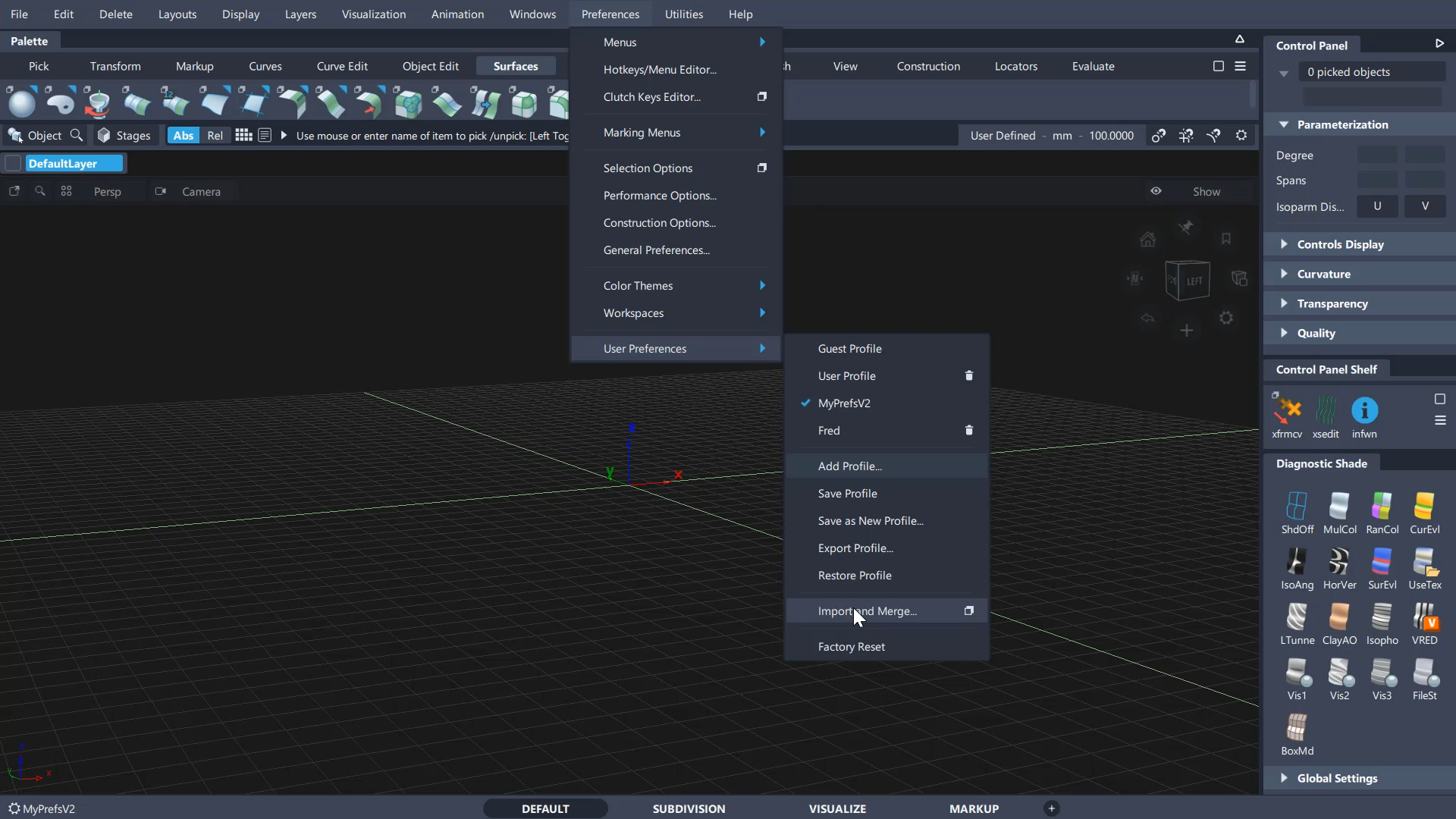

  • In User Preferences, there's a new format for saving your interface setup called User Profiles.
  • So when I arrange the interface to my preferred layout, so docking the palette, for example, or customize it by adding tools to a shelf, then I can save that arrangement to this default user profile here by using Save Profile.
  • But now with Profiles, I can also create additional preferences.
  • So if I dock the palette up here instead and change colors, for example, then that's not going to affect this saved user profile unless I do a save.
  • So I can do a Save as instead and create a new one called MyPrefsV2.
  • And then that's added to the list and I can switch between those profiles either here and I'll go back to the user profile, or down here on the shortcut bar so I'll just switch back to my new prefs.
  • During a normal work session, I'll open and move windows and generally mess up the interface.
  • All these changes are also saved by an automatic background process of saving the system preferences.
  • So now there's no warning about saving prefs when I exit,because when I relaunch. I just pick up seamlessly from where I left off.
  • But if you prefer to start from the tidy layout, you can always reset to your stored prefs using Restore Profile.
  • For backups or copying to other machines, you can use Export Profile to save a .json format file onto disk.
  • And you can see that this no longer goes into the system directory by default.
  • So I'll save that and then to load one back in, I can use Add Profile and select the .json file that maybe your colleague has exported.
  • So that's then added to the list and can be switched to if we're collaborating on one machine, for example.
  • But that .json format is different from the .aps format used in previous Alias versions.
  • So to bring in my old preferences, I need to use Import and Merge instead and choose the elements I want to bring in.
  • So I'm gonna turn off Workspaces so that I keep this new control panel group and colors because I hadn't customized those.
  • And I'll get my exported preference set from Alias 2023.
  • So then I can find my marking menu here as the second default and I'll switch to that.
  • And my shelf will be loaded into the default here so I can open that and all my tools are there, which has saved me a lot of setup time.
  • So once I've got that as I want it, I can do a Save as and I'll just call it MyImportedPrefs.
  • And then finally, the Guest Profile here is just a right protected, very simple standard interface that will be the same on every installation, so there's consistency if you need it.
  • And the factory reset can be used if you prefer to start from an absolute minimum interface and build up your working environment from scratch.
