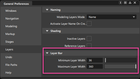

New Minimum Layer Width and Maximum Layer Width preferences now let you customize the width of the layer display in the Layer Bar. Use this to shorten layer bars when you have several layers in your scene or make it larger when you have fewer layers. You can set these preferences in Preferences > General Preferences > Layers > Layer Bar.

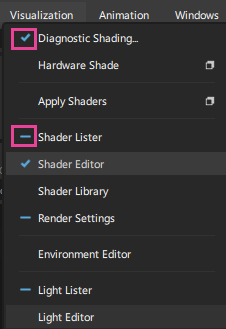

  • When multiple windows are grouped, such as in a tabbed group, a new check icon in the menu now indicates which one is actively open. A dash icon is used to indicate which windows are open but not currently visible. Clicking the dash icon makes that window the active window in the group. In previous versions of Alias, the check icon was used to only indicate that the window was open.

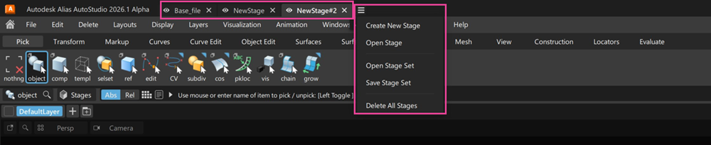

New Stage Tabs​
​ When opening files in Alias, there are now tabs that display the file name at the top of the application window. With the convenience of displaying the stages across the top, you can access Stage Editor options from a drop down menu. Clicking on the tab with the Alt key also isolates the stage like in the Stage Editor.​ Note that you can still access the Stage Editor from the Stages button along the action bar.

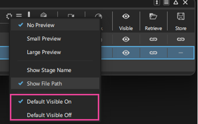

  • You can now control the default visibility of stages when opening or importing files. New Default Visible On and Default Visible Off options in the Stage Editor settings lets you decide whether newly loaded stages are visible by default.

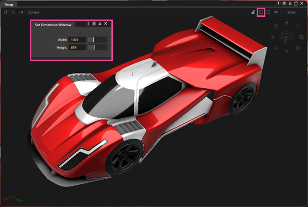

  • Set Floating Window size - You can now set the dimensions of floating windows. After creating a New Floating Window, click the Set Dimension icon (icon), then type values for Width and Height in the Set Dimension Window.

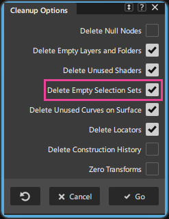

  • Clean Up Options – The Cleanup Options window now includes a Delete Empty Selection Sets option. This option is enabled by default and allows you to delete empty selection sets when you run the Delete > Clean Up tool.

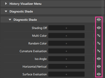

  • You can now hide diagnostic shaders from appearing in the Diagnostic Shaders window when using Short Menus. Open the Hotkey Menu Editor then click the Short Menu icon for diagnostic shaders you want to hide.

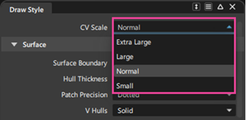

  • We've added a new CV Scale in the Display > Draw Style options, which now lets you choose between four different CV sizes. The new larger draw sizes are especially helpful when working on high-resolution monitors to improve visibility. Note that this is a global setting that affects curve, NURBS surface, and subdivision object CVs.

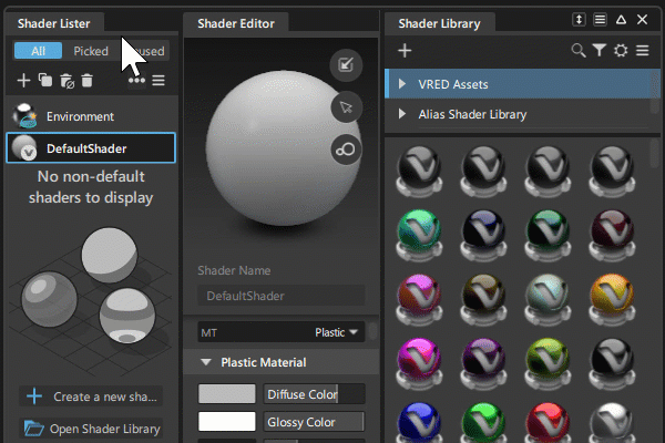

  • Shader Lister – Loading and interacting with shader previews has been improved.

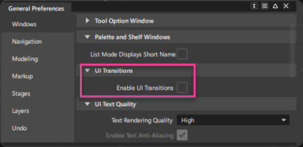

  • UI Transitions – Added a preference that lets you turn off UI transitions to further improve performance.
