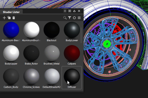

Assigned shaders highlighting
Shaders assigned to picked objects now display with blue corners in the Shader Lister. This allows you to box-select objects in the viewport and quickly see which shaders are assigned to them.

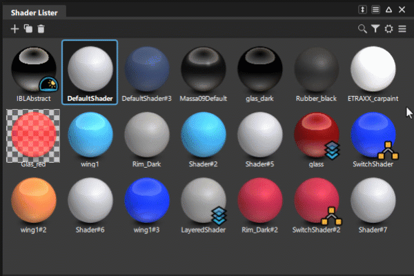

New Sort by options
New Sort by options in the Settings menu of the Shader Lister let you organize your shaders alphabetically or in the order they were created. Additionally, you can now also group shaders by type, for example shader, layered shader, and switch shader.

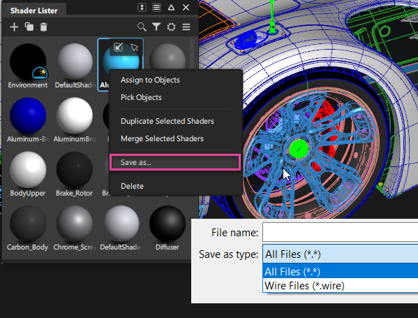

Exporting shaders
When saving a shader from the Shader Lister using Save as, Wire Files(* .wire) now appears as a Save as type in the file browser window.
