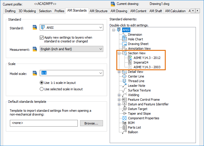

Option Dialog Box
In AutoCAD Mechanical 2024 toolset, the new ANSI standard revision is the default standard for a new drawing. When you open a legacy drawing, the default standard is changed to the old standard revision. You can change the standard revision in the Options dialog box.
Section Line Settings for ANSI Dialog Box

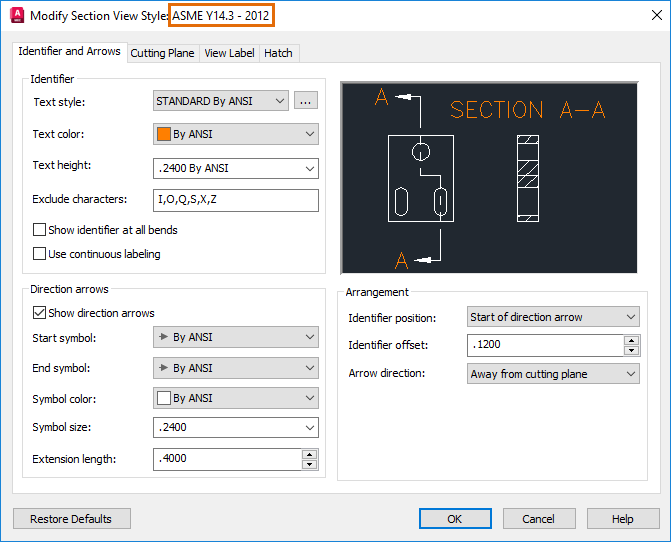

The new revision is displayed in the Modify Section View Style dialog box.

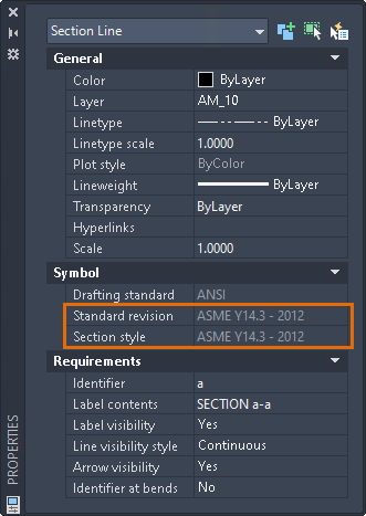

Properties Palette
View and modify all section line symbol properties in the Properties palette.
