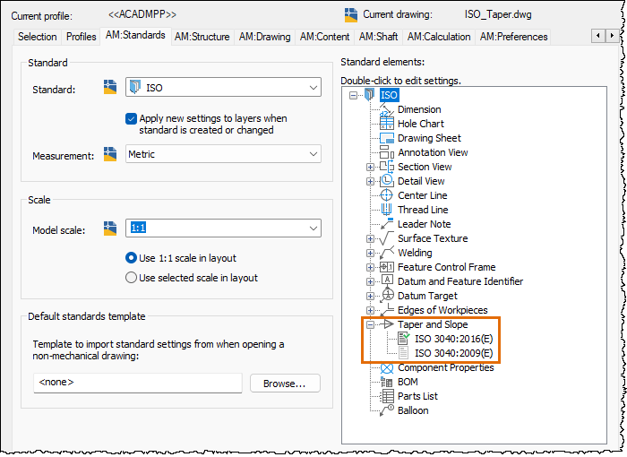

Options Dialog Box
In AutoCAD Mechanical 2024 toolset, when opening a legacy drawing, the default standard is changed to the old standard revision. You can change the standard revision in the Options dialog box.

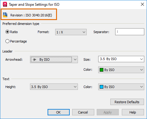

Taper and Slope Settings for ISO Dialog Box
The new revision is displayed in the Taper and Slope Settings for ISO dialog box.

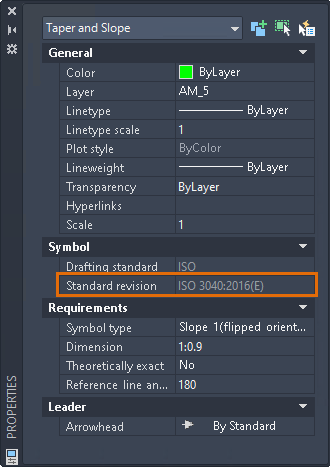

Properties Palette
View and modify the taper and slope symbol properties in the Properties palette.
