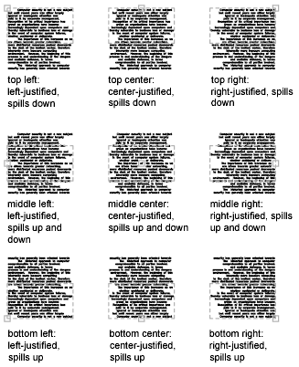

Determines both text justification and text flow, for new or selected text, in relation to the text boundary. The current justification is applied to new text. The text is justified within the specified rectangle based on the justification setting and one of nine justification points on the rectangle. The justification point is based on the first point used to specify the rectangle. Text is center-, left-, or right-justified with respect to the left and right text boundaries. Spaces entered at the end of a line are included as part of the text and affect the justification of the line. Text flow controls whether text is aligned from the middle, the top, or the bottom of the paragraph with respect to the top and bottom text boundaries.
Justify Options
Option
Meaning
TL
Top Left
TC
Top Center
TR
Top Right
ML
Middle Left
MC
Middle Center
MR
Middle Right
BL
Bottom Left
BC
Bottom Center
BR
Bottom Right
The following illustrations show each justification option.
