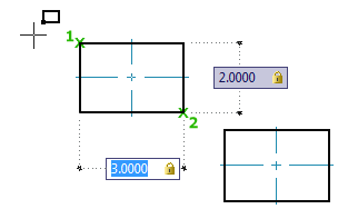

You can select a convenient starting point (a corner, midpoint of base, midpoint of height, or center of rectangle) and specify the height and base by entering distance values on the tooltips that show the dimensions of the rectangle. You can also change the shape of the corners and control if centerlines are drawn with the rectangle.

- Defines the second point required to draw the rectangle. When dimensional input is on (DYNMODE=3), tooltips display distance to the second point. You can Press TAB to move to the value you want to change and specify the distance to the second point using the keyboard.

Centerline
Creates a rectangle with centerlines.
- Base
- Draws a centerline parallel to the base.
- Height
- Draws a centerline parallel to the height.
- Both
- Draws centerlines parallel to the base and height.
