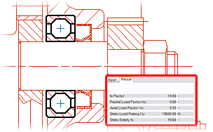

Determines the limiting value, dynamic and static load rating, dynamic and static equivalent load, and fatigue life of a bearing .
Find
Summary
The rating life calculation can be applied when inserting a bearing as an additional selection criterion or as a calculation without inserting a bearing.
Note: The rating life calculation can be applied when inserting a bearing as an additional selection criterion or as a calculation without inserting a bearing. Therefore there are some differences in the command sequence.
The calculation is controlled by dialog boxes.
