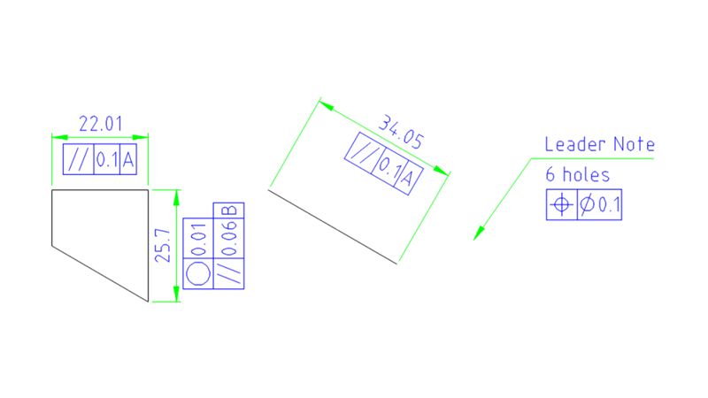

You can create feature control frame symbols which are associated to text within dimensions, hole, thread notes, and leaders. The feature control frame symbols are also positioned in accordance with the international drafting standards.
The feature control frame command (AMFCFRAME) is enhanced to allow the selection of an existing annotation's text. When the text of an existing annotation (dimension, hole, and thread note text) is selected, the symbol's preview is automatically placed below the selected text. The text is positioned based on the alignment of the selected text.
