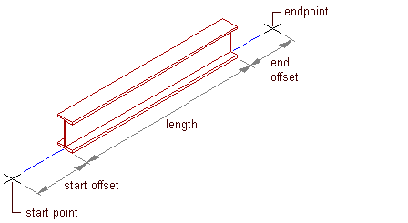

  7. Specify offsets:
    If you want to… Then…
    offset the beam on its extruded axis at the start point of the beam enter a value for Start offset. A positive value shortens the beam on its axis, while a negative value lengthens the beam on its axis.
    offset the beam on its extruded axis at the endpoint of the beam enter a value for End offset. A positive value lengthens the beam on its axis, while a negative value shortens the beam on its axis.

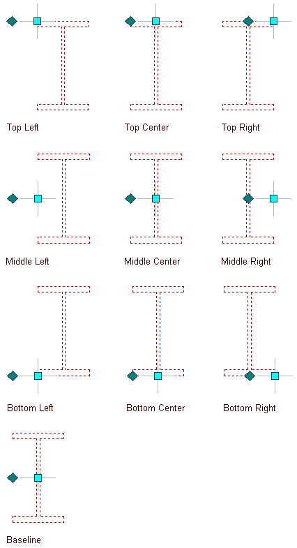

  9. Specify the beam justification, which positions the beam shape in relation to its extruded axis when you draw the beam:
    position the axis of the beam along the centroid of the beam shape select Baseline for Justify.
    Note: This applies to members created with styles from the Structural Member Catalog only.
    position the axis of the beam along one of 9 positions on the beam shape select one of the 9 positions for Justify.
    Note: These positions are defined at a roll of zero, viewing the beam from the end to the start.
    Justification options for a beam

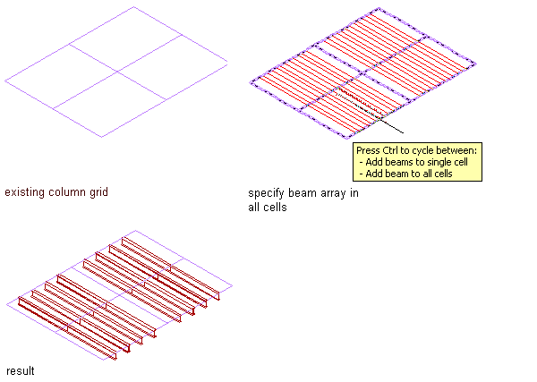

  11. If Layout type is Fill, and you want to array multiple beams between 2 existing beams or within a column grid, slab, roof slab, or wall, expand Layout and select Yes for Array.
  12. Specify the layout method for the array:
    If you want to array beams… Then…
    so that they create a specific number of equal-sized bays select Space evenly for Layout method, and enter a value for Number of bays.
    at a specific distance from each other select Repeat for Layout method, and enter a value for Bay size.

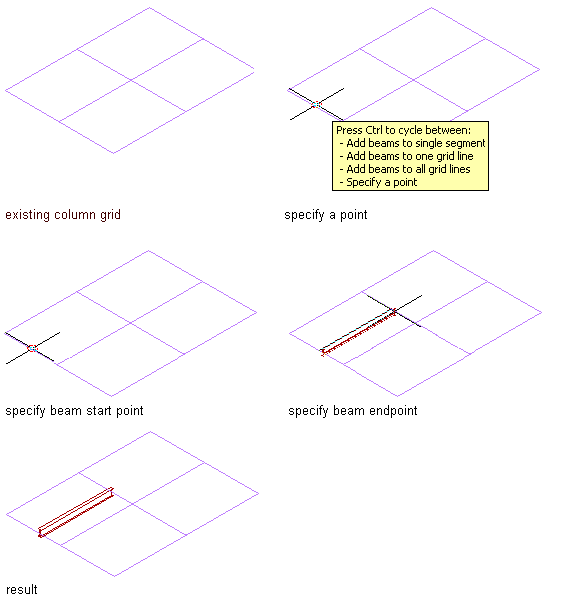

    Adding a beam to a specified point

    Adding a beam array to all cells
  14. Position the new beams in the drawing area:
    create a single beam independent of other objects specify a start point and an endpoint for the beam, and then press Enter.
    create multiple beams independent of other objects but connected to each other using the endpoint of one beam as the start point of the next beam specify a start point and an endpoint, and then specify additional endpoints as required. Press Enter to end the command.
    create a beam that is connected to an existing structural member specify a start point and an endpoint, one of which must be on the axis or the endpoint of the existing member. Press Enterto end the command.
    add a beam along one or more edges of a slab, roof slab, or wall (assuming Layout type is Edge) move the cursor over an edge of the object until a preview of the beam is displayed, and then click to add a beam along that edge, or press Ctrl and click to add beams along all edges of the object. Press Enter to end the command.

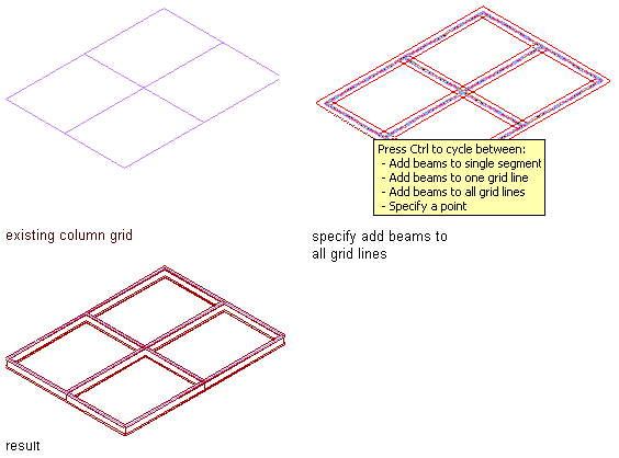

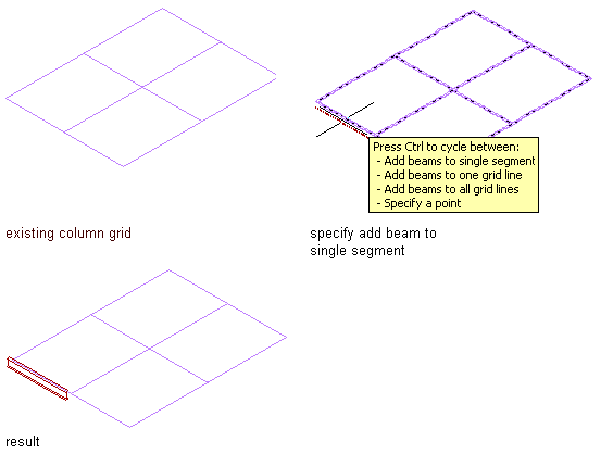

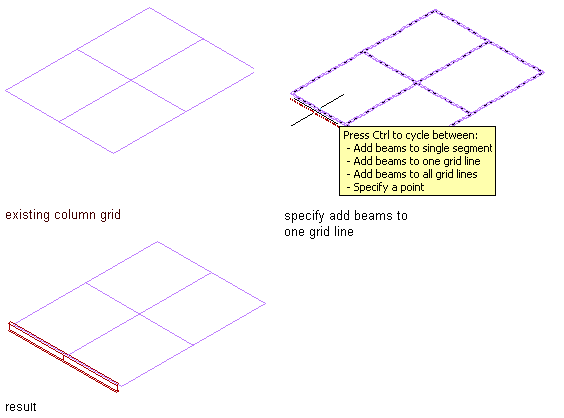

    add a beam along one or more segments of a column grid (assuming Layout type is Edge) move the cursor over a segment of the grid until a preview of the beam is displayed, and then click to add a beam along that segment; or press Ctrl and click to add beams along all segments in that grid line; or press Ctrl twice and click to add beams along all segments in the grid. Press Enter to end the command.

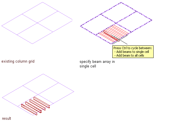

    array beams perpendicularly within a slab, roof slab, wall, or one or more cells of a column grid (assuming Array is Yes) move the cursor over an edge until a preview of the array is displayed, and click. New beams are arrayed perpendicular to the selected edge according to the Layout Method selected on the Properties palette. If you want to add the array to all cells of a column grid, press Ctrl before clicking. Press Enter to end the command.
    array beams at an angle other than 90 degrees within a slab, roof slab, wall, or one or more cells of a column grid (assuming Array is Yes) move the cursor over an edge until a preview of the array is displayed, enter a value for the desired angle, press Enter, and then click. New beams are arrayed at the specified angle according to the Layout Method selected on the Properties palette. If you want to add the array to all cells of a column grid, press Ctrl before clicking. Press Enter to end the command.
