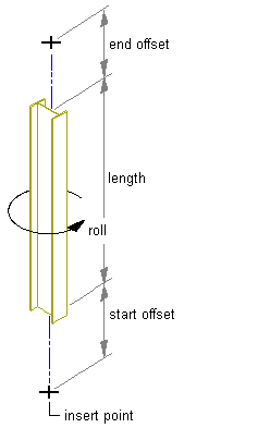

Use this procedure to create a new freestanding column with property settings that you specify. The style specified in the tool provides the column shape. When you specify an insert point for the column, the shape is extruded in a positive direction along the current UCS Z-axis to a height determined by the Start offset, End offset, and Logical length properties you specify.
Creating a free-standing column
Optionally, offset the column from its start point or endpoint.
Offsetting a column

  5. Expand Dimensions.
  6. Specify offsets:
    If you want to… Then…
    offset the column on its extruded axis at the start point of the column enter a value for Start offset. A positive value shortens the column on its axis, while a negative value lengthens the column on its axis.
    offset the column on its extruded axis at the endpoint of the column enter a value for End offset. A negative value lengthens the column on its axis, while a positive value shortens the column on its axis.
  7. Enter a value for Logical length.
    The logical length of the column is the length (height) of the column before offsets are applied.
  8. Select Yes or No for Specify roll on screen:
    specify the roll of the column before you insert it select No for Specify Roll on Screen, and enter a value for Roll.
    specify the roll of the column when you insert it select Yes for Specify Roll on Screen, and specify the roll as explained in step 10.
    A positive value rolls the column counterclockwise around its extruded axis when viewed from its end (top) to its start (bottom).
