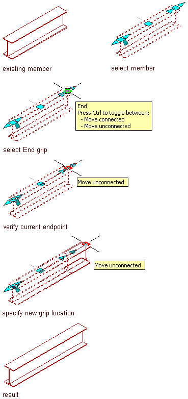

    Change the end of a beam structural member with grips
  3. Select a Start or End grip, move the grip until the length value you want is displayed, and click once.
    After selecting a grip, you can also enter a value to increase or decrease the length of the structural member.
