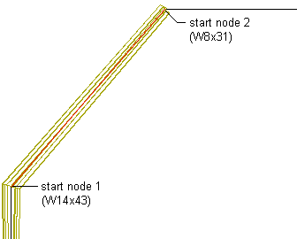

Use this procedure to create the first rafter of the rigid frame by assigning a different start and end shape to the second segment of the rigid frame member.
Creating the first rafter of the rigid frame
  1. Click Add to add a second component to the structural member.
  2. Select Unnamed under Component, and enter Rafter 1.
  3. Under Start Shape, in the Name list, select W14X43.
  4. Select Start for Relative to.
  5. Enter 1 for Node.
  6. Scroll to the end of the Design Rules dialog box to display the End Shape parameters for Rafter 1.
  7. Under End Shape, in the Name list, select W8X31.
  8. Select Start for Relative to.
  9. Enter 2 for Node.
