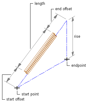

Use this procedure to add a new brace with property settings that you specify. The style specified in the tool provides the brace shape, which is extruded along the path you define by specifying a start point and an endpoint.
Creating a brace
Optionally, offset the brace from its start point or endpoint.
Offsetting a brace

  5. Expand Dimensions.
  6. Specify offsets:
    If you want to… Then…
    offset the brace on its extruded axis at the start point of the brace enter a value for Start offset. A positive value shortens the brace on its axis, while a negative value lengthens the brace on its axis.
    offset the brace on its extruded axis at the endpoint of the brace enter a value for End offset. A positive value lengthens the brace on its axis, while a negative value shortens the brace on its axis.
  7. Enter a value for Roll.
    This value specifies the orientation of the brace relative to its extruded axis in terms of degrees of roll. A positive value rolls the brace counterclockwise when viewed from its end to its start.

  9. Specify the rise, which is the vertical distance between the start point and endpoint of the brace:
    specify the rise of the brace before you draw it select No for Specify rise on screen. For Method, select either Angle, Distance, or Height. If you select Angle, enter a value for Distance along first member (measured from the point where the two members are connected to the point on the first member where you want the brace to start) and a value for Angle from first member. If you select Distance, enter values for both Distance along first member and Distance along second member. If you select Height, enter a value for Rise.
    specify the rise of the brace by specifying a 3D endpoint for the end of the brace. select Yes for Specify Rise on Screen.
