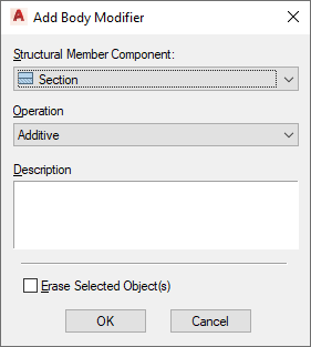

  5. In the Add Body Modifier dialog box, select Additive for Operation.
  6. Enter a description for the body modifier.
  7. Select Erase Selected Object(s) if you do not want to keep the original object, or clear this option to keep the object in the drawing.
  8. Click OK.
