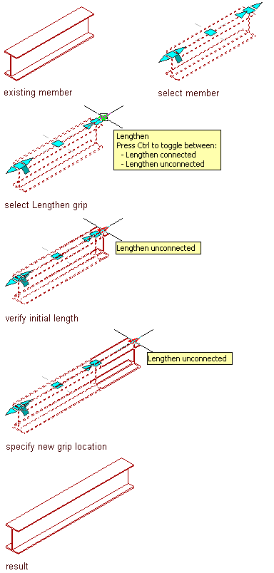

Use this procedure to change the length of a structural member. You can also change the structural member length on the Properties palette.
  1. Select the structural member.
  2. Select a Lengthen grip, move the grip until the length value you want is displayed, and click once.
    Changing the length of a beam structural member with grips
    After selecting a grip, you can also enter a value to increase or decrease the length of the structural member.
