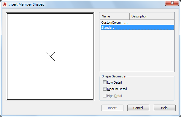

Use this procedure to insert one or more of the geometries defined for a custom shape into a drawing. The geometry can then be edited or used as is to define one of the display representations for another custom member shape you are creating or editing.
  1. Click Manage tabStyle & Display panelMember Shape.
  2. In the right pane of the Insert Member Shapes worksheet, select a custom member shape.
  3. Click one or more of the Shape Geometry check boxes.
    The geometry for each selected shape designation is highlighted in the viewer.
  4. Click Insert.
  5. Specify an insertion point for each of the selected shape designations in the drawing area.
