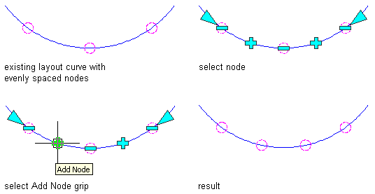

Adding a node to a layout curve using grips

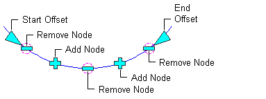

- Select the layout curve by selecting one of the node anchors.
- Click an Add Node grip.
Alternatively you can click
- If you have added a node to a layout curve with manually spaced nodes, the new node is inserted at the specified position. The position of the other nodes remains unchanged.
- If you have added a node to a layout curve with evenly spaced nodes, the new node is added and all nodes are recalculated, so that they are evenly spaced again.
- Right-click, and click Deselect All to turn off grips.
