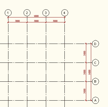

You can dimension an enhanced custom column grid. The dimension command on the contextual column grid tab will create a 2-chain grid dimension for the overall grid extent and the grid bays.
Note: The dimension command on the contextual Grid tab inserts AutoCAD dimensions.
  1. Select the enhanced custom column grid.
  2. Click Column Grid tab Custom Column Grid panel Dimension Grid.
  3. Select the grid.
  4. Define the offset of the dimension from the grid.
    By default, a set of rotated dimensions with the Annotative dimension style are created. If you want to change the dimension style, select the dimensions and set a different dimension style in the Properties palette.
