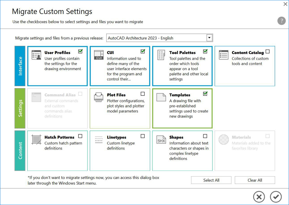

  1. On the Windows Start menu, click AutodeskAutoCAD <product and release> folder drop-down listMigrate From a Previous Release.
  2. In the Migrate Custom Settings dialog box, select the release from which you want to migrate.
  3. Select the custom settings you want to migrate over to the latest release.
  4. Click to start the migration process.

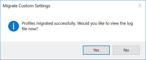

  5. In the Migrate Custom Settings message, click Yes to view the migration log file. Otherwise, click No.
